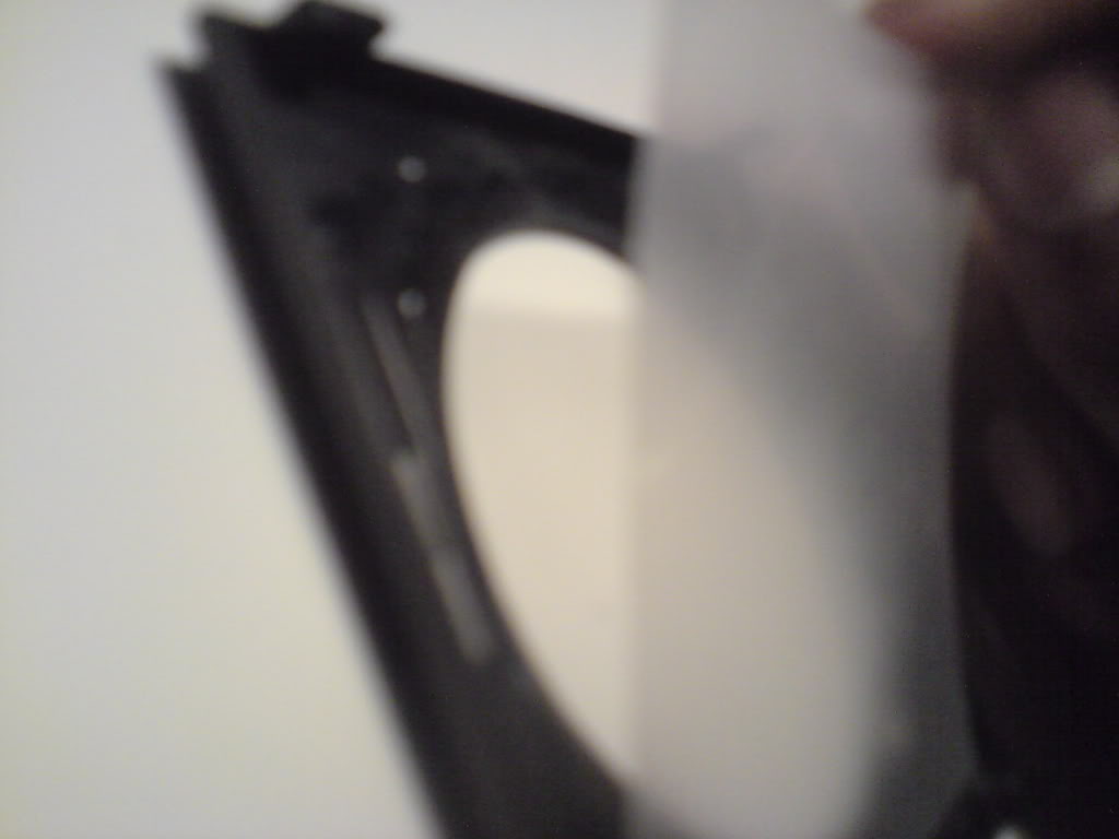

1- Start off with you psp and gut it(remove all the insides)
Sorry about the blurriness i will fix it later
2- Grab your deadly weapon(No, not your sniper rifle). :cool:
3- And start stabbing.
Don't push it too far down or it will break.
4- Twist your knife and it should pop free.

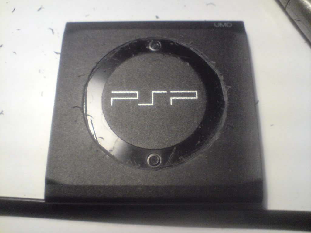

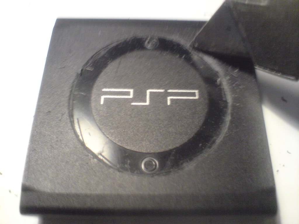

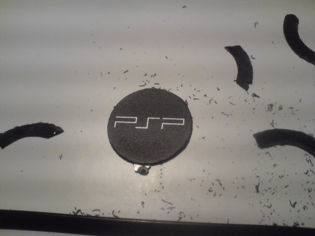

1.ok first things first take the umd door off (don't ask me how)
put it somewhere and switch on the hairdryer and apply heat on the silver ring.
2.after you know for sure the glue under the ring has melted, get a small flat headed screwdriver and peel off the ring.

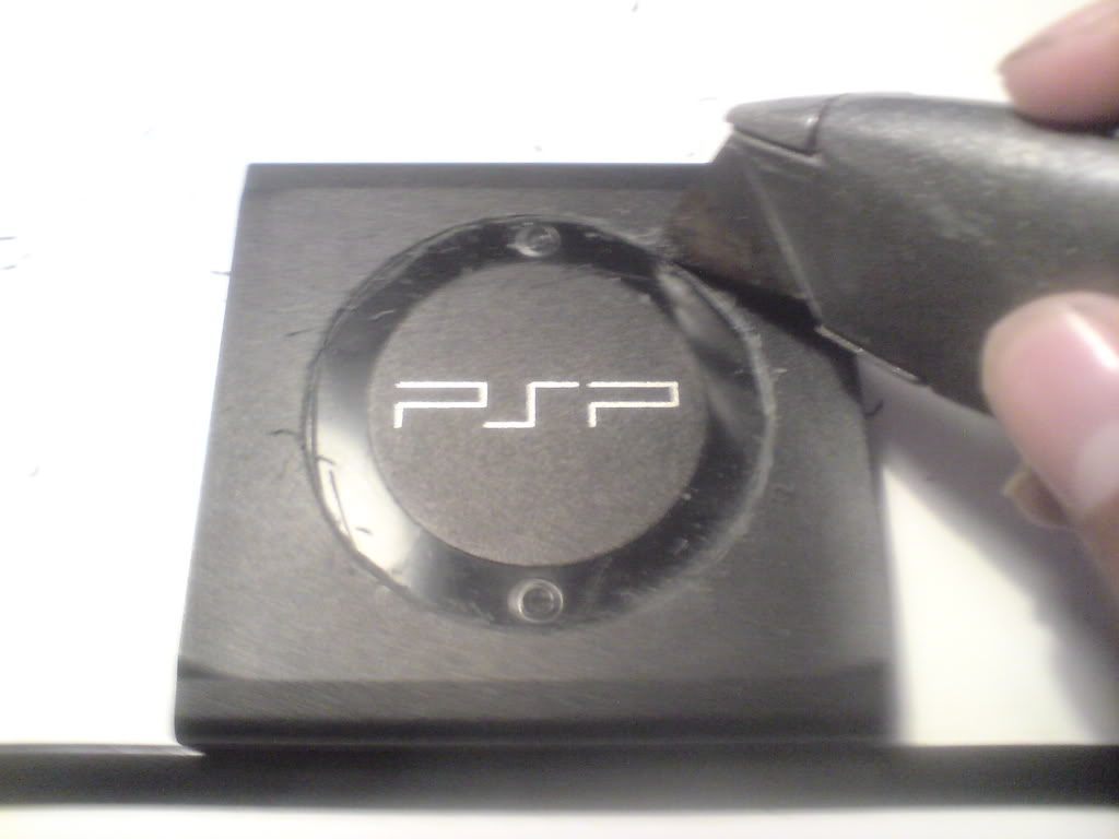

3.get your blade and start carving the circle out
half an hour later
an hour later
success

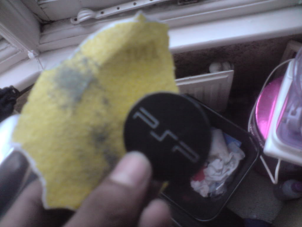

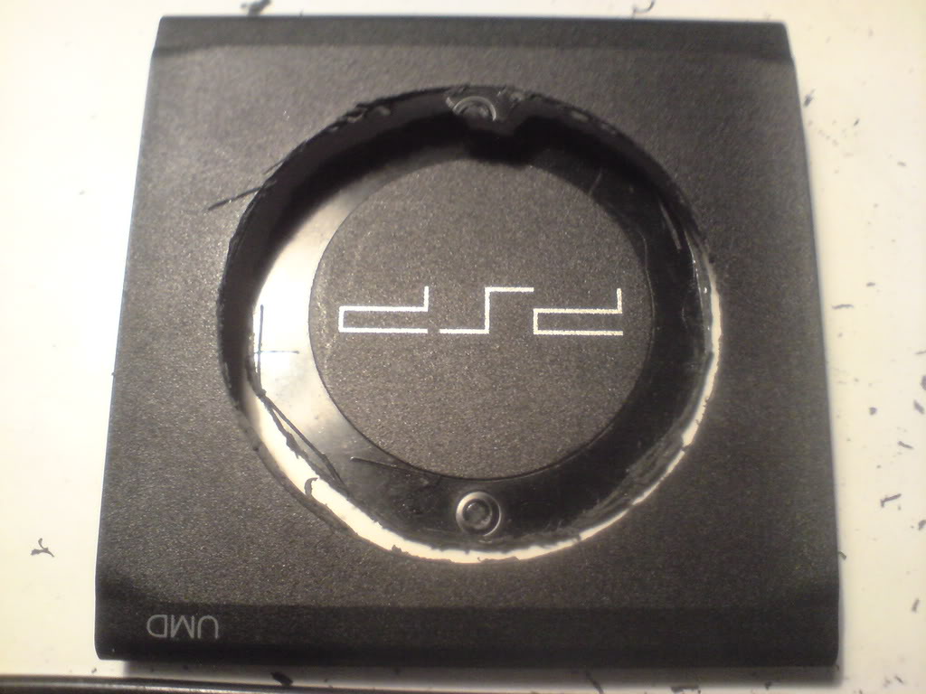

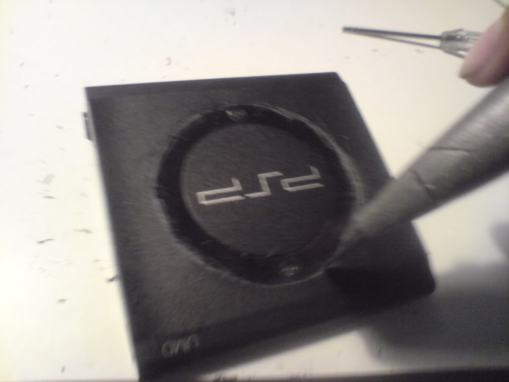

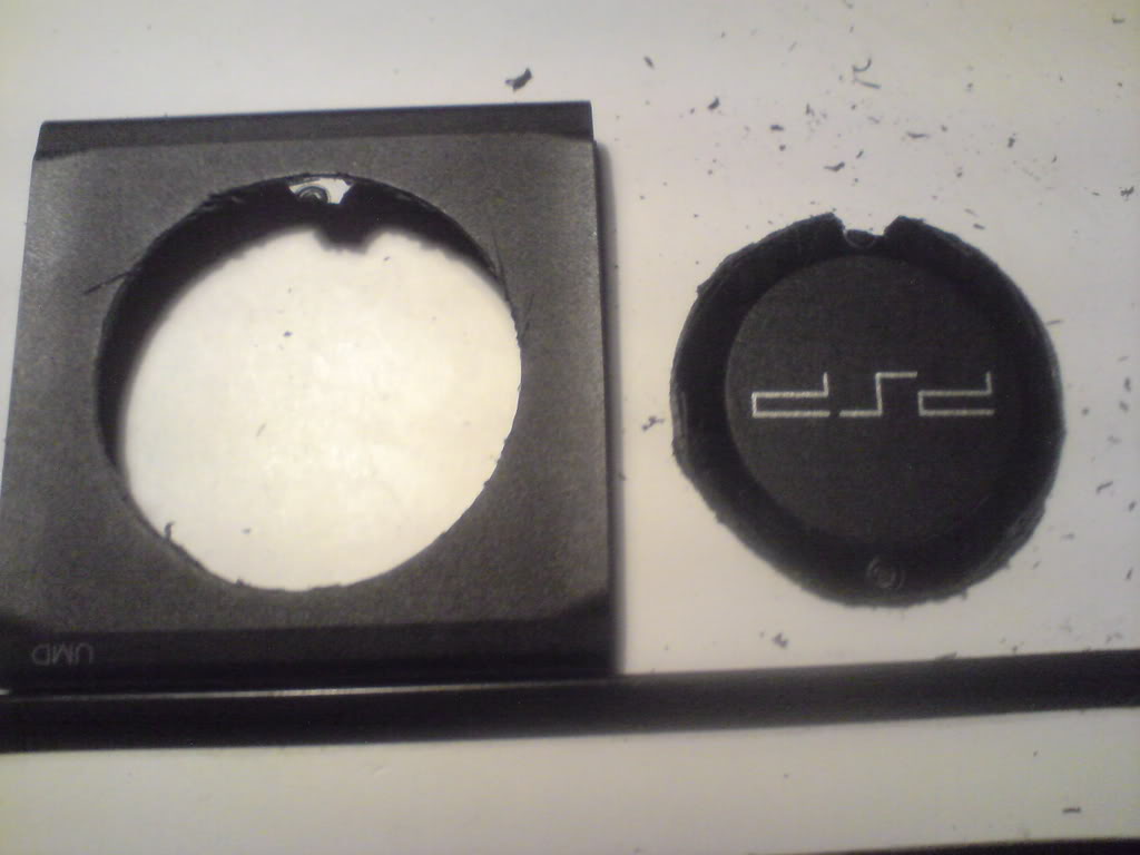

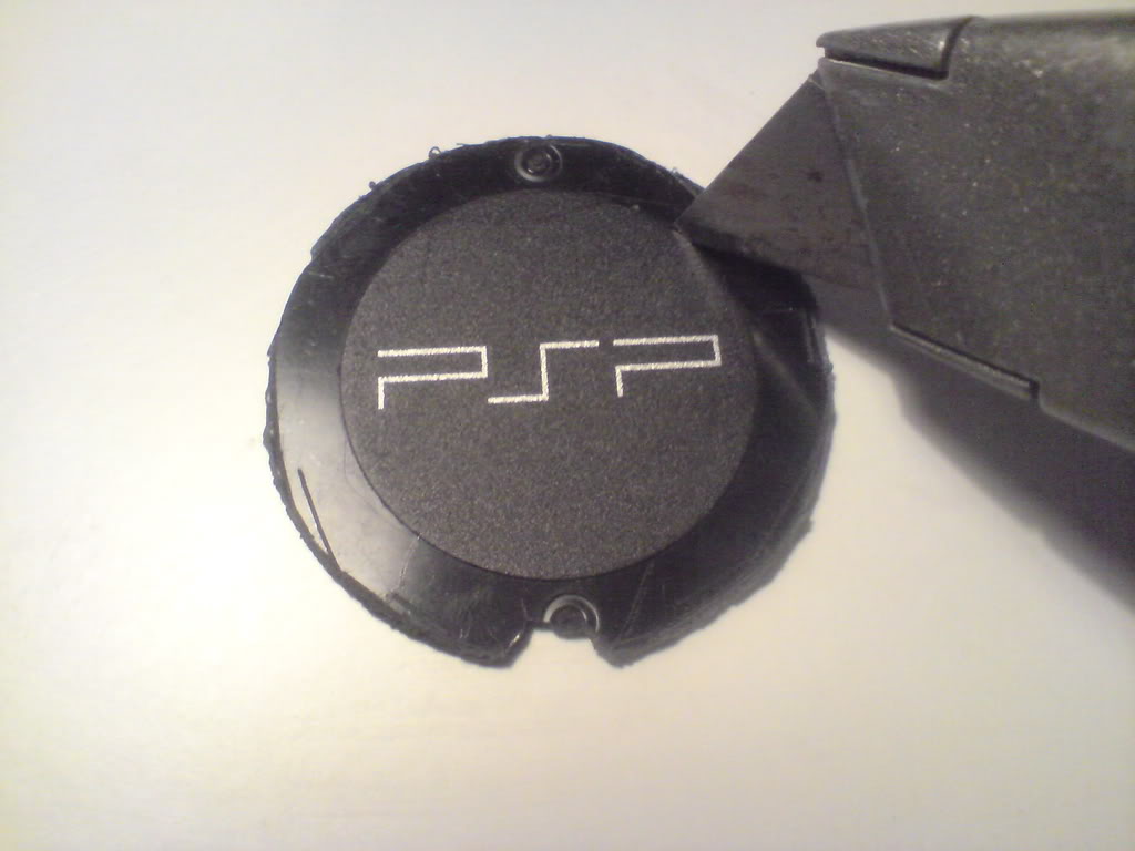

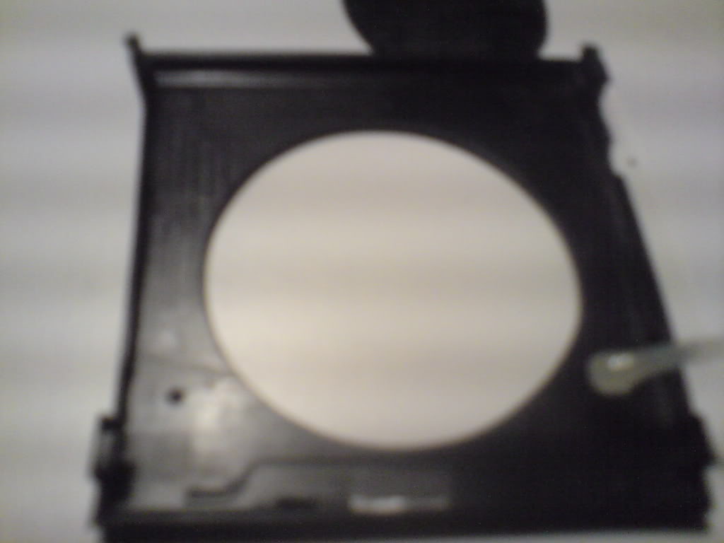

4.ok now take out the middle bit
yup and you guessed it carve around it
until it looks pretty :rofl:

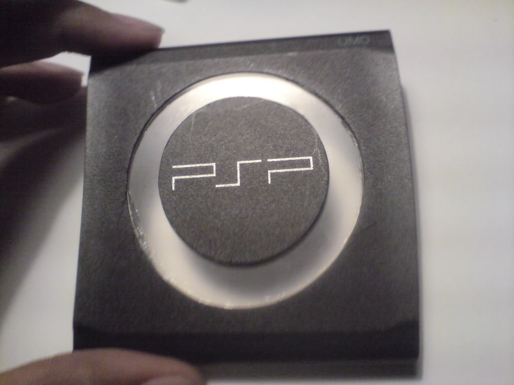

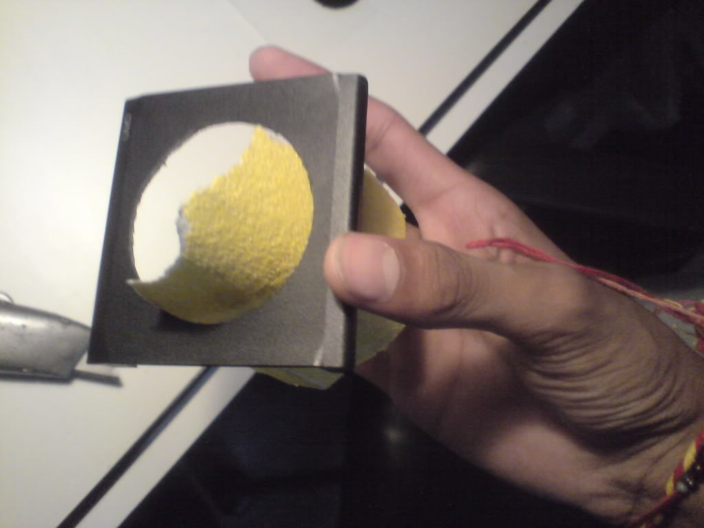

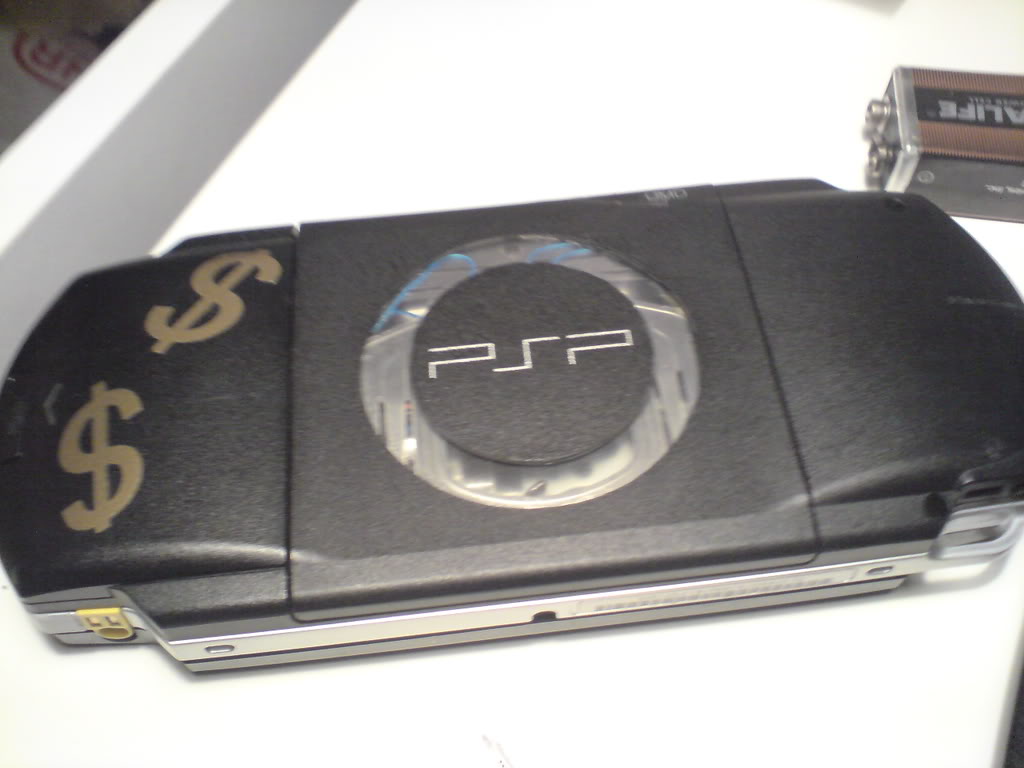

5.get your sandpaper now and make the edges nice and round and smooth
ta daaaa :faint:

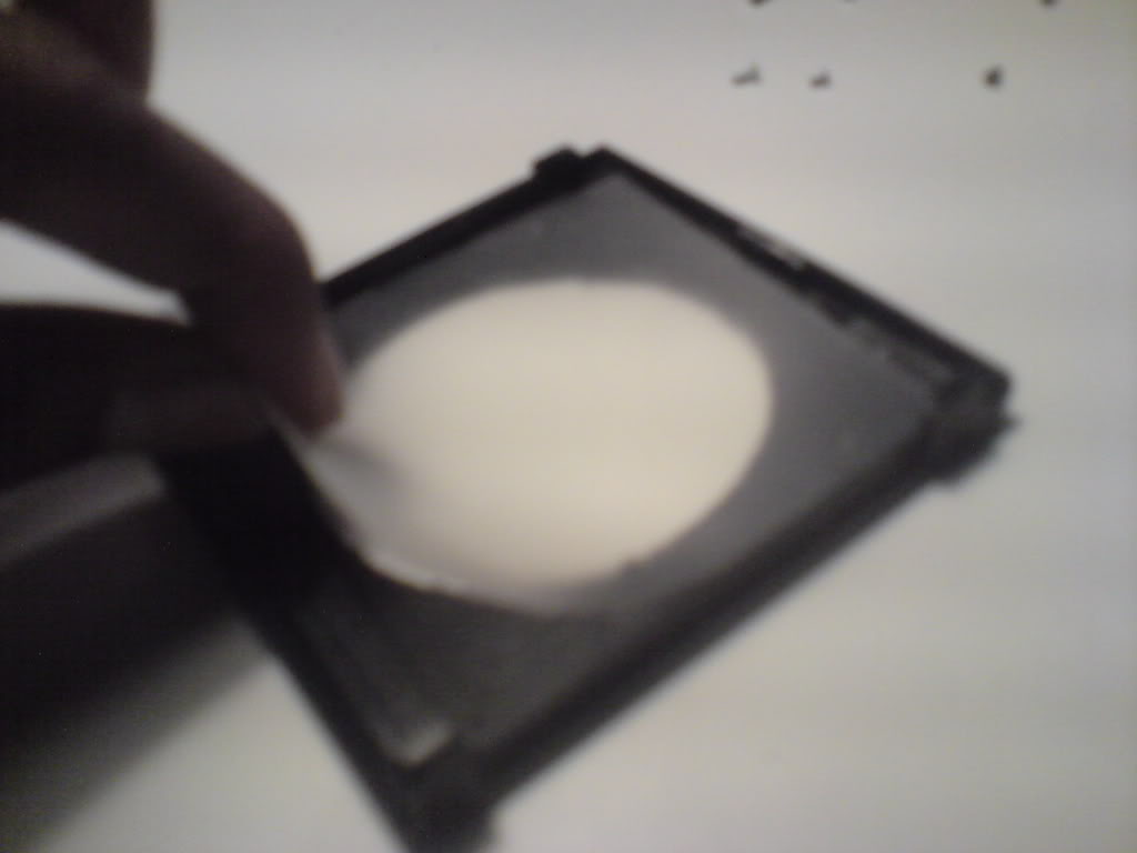

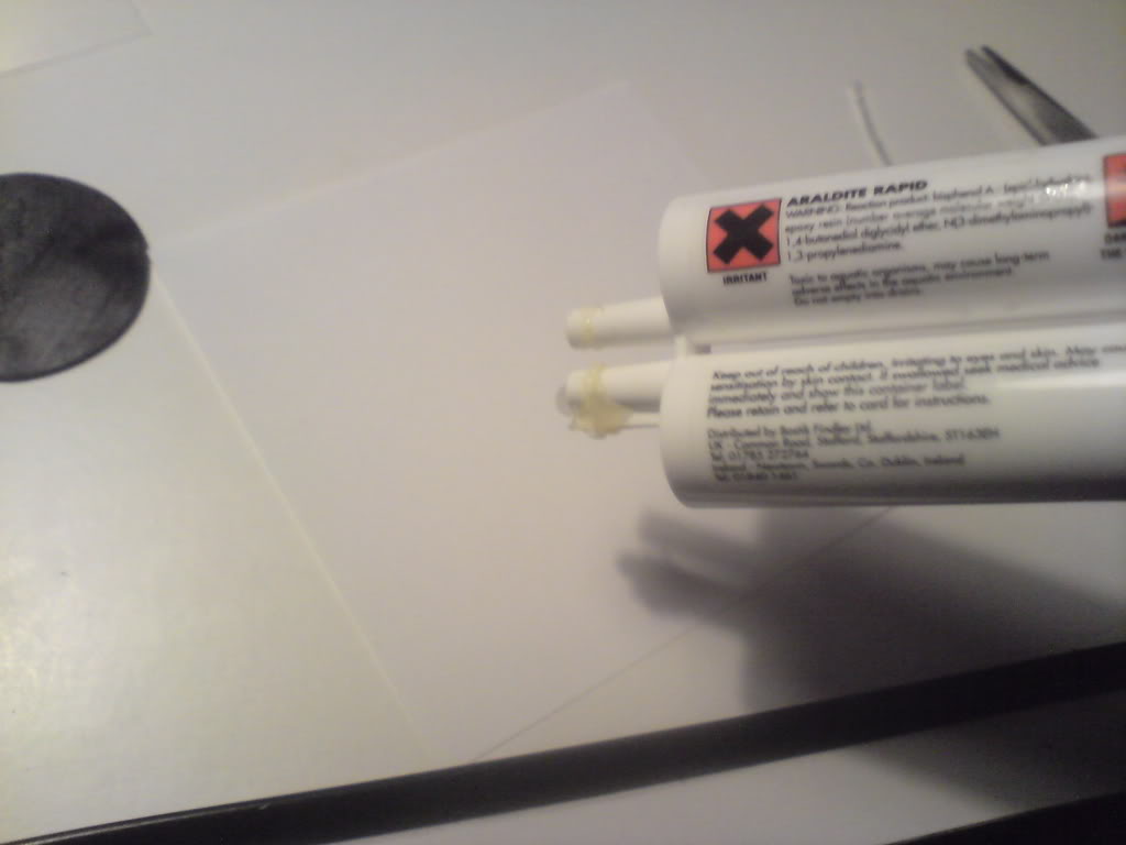

6.now the folder, get the sicissors and cut a square out the size off your umd door. it should fit snugly inside with no gaps

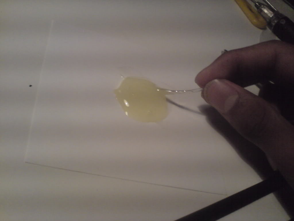

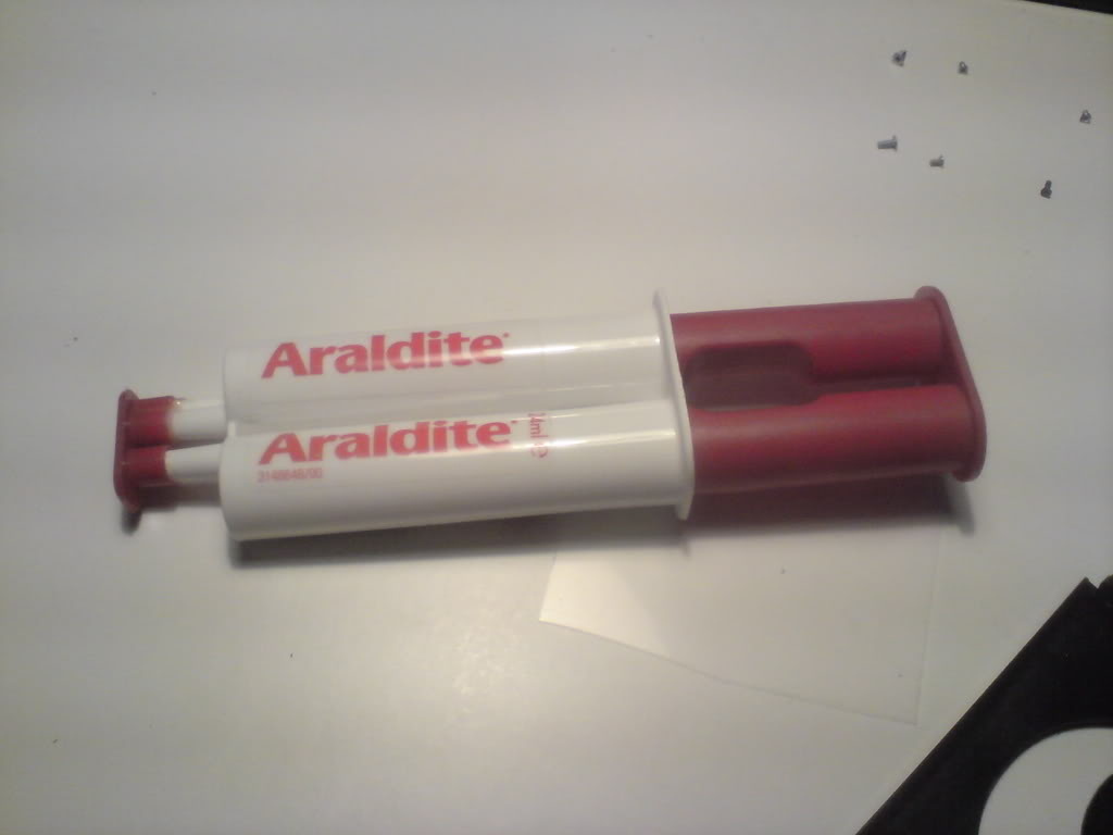

7.get your super stong glue
mix it if you have to
and put it on a piece of scrap paper.

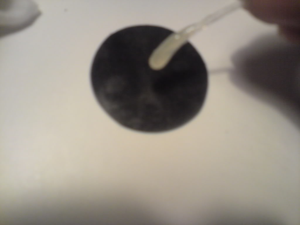

find some rubbish (i'm using a plastic tube) and use it to apply the glue around the inside of the umd door(don't apply too much or it will come out the front)
8.now put the sheet of plastic on
9.put a blob of glue on the centre bit
and stick it on
10.now heres the hardest bit in this whole tut, LEAVE IT ALONE TO DRY AND DON'T TOUCH OR PROD IT

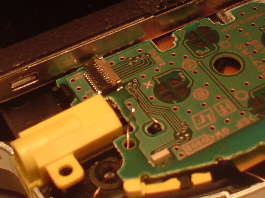

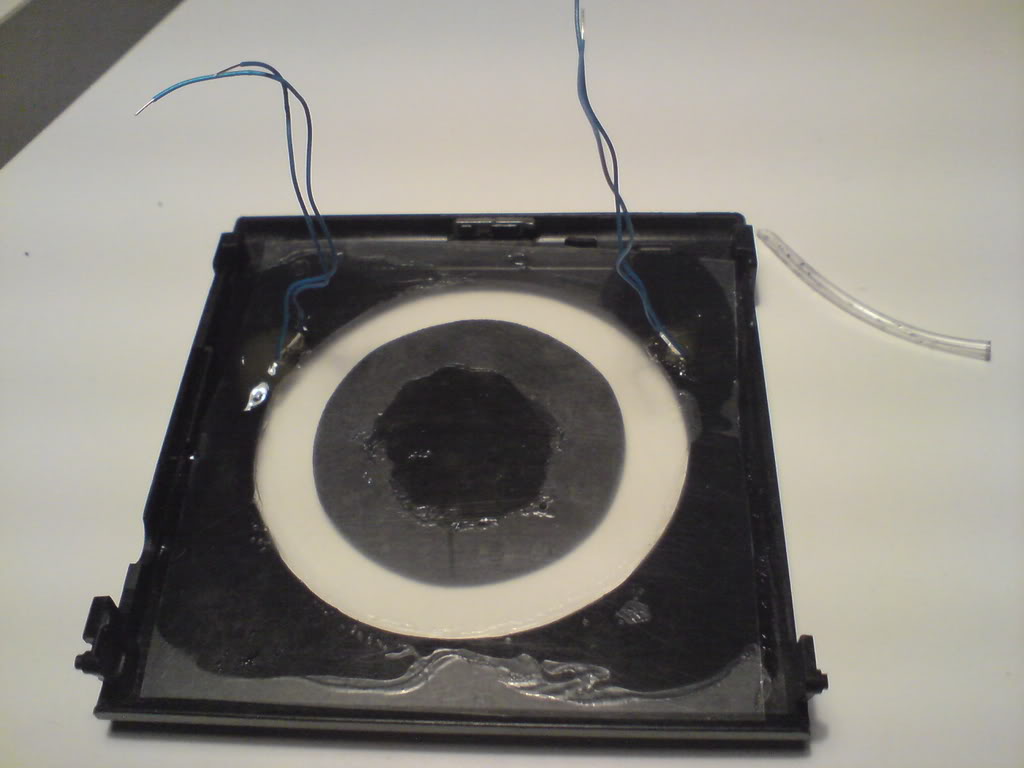

11.solder your 10ohm resistor to your smd and two wires

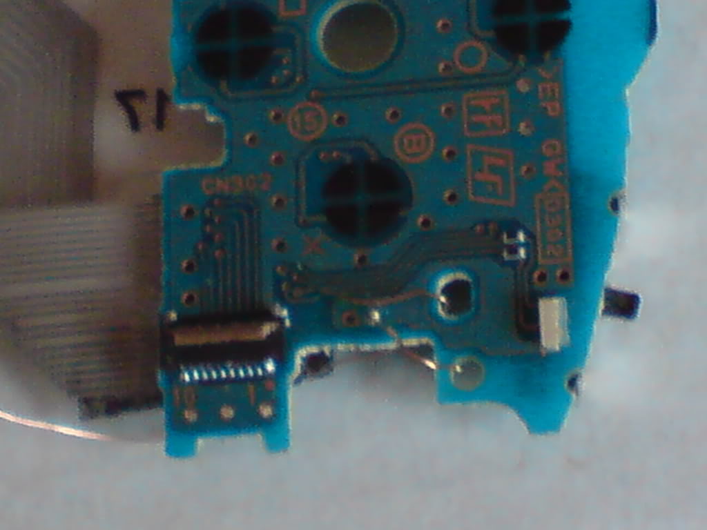

12.solder two wires onto the powerboard
look here an easier way and the positive and negative poles
https://www.acidmods.com/forum/index.php?topic=18429.0
13.glue the smds on the umd door

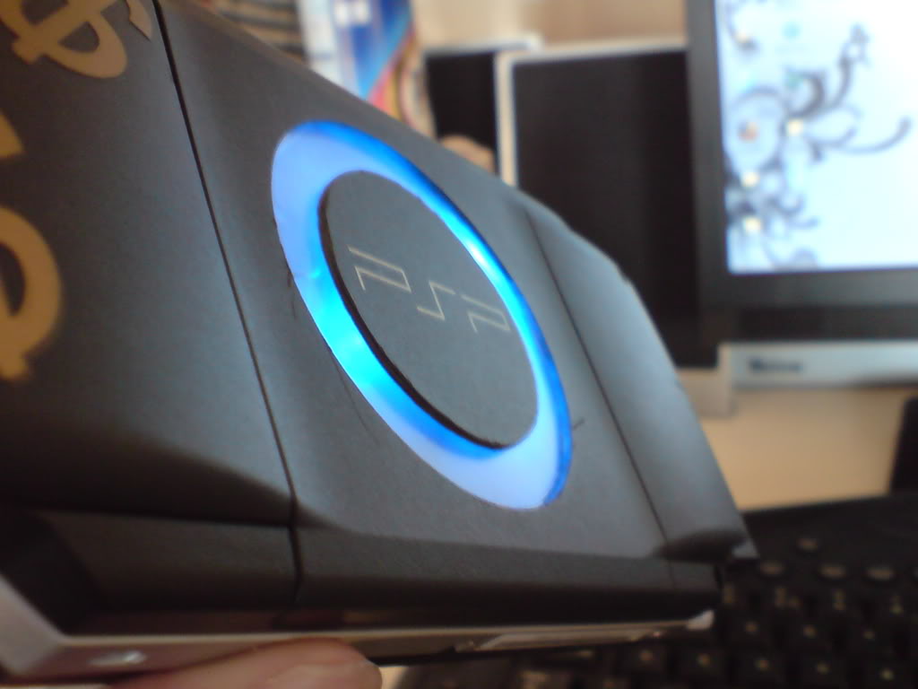

14. this is a confusing bit, you must solder the smd's too the powerboard, try them out first before soldering them.
ta da da dat daa daaa daaaaaa!!!! :#1:
stick the umd door back on carefully
and try it out

I didn't do the ring of light, instead I put clear plastic where the PSP logo is on the UMD door, and now, it won't play any UMD's. The thing that spins the disk will spin, but it doesn't catch the disk. Did I do something wrong?
