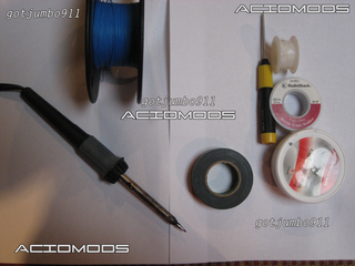

Parts Needed
-- PSP
-- 2x 603 SMD Led
-- 30 Gauge Kynar Wire [Two Colors is Best]
Tools Needed
-- 15-30 watt Soldering Iron
-- Solder
-- Screwdriver
-- Flux
-- Electical Tape
Average Time To Complete- About 45-60 Minutes
Difficulty Rating-3/5

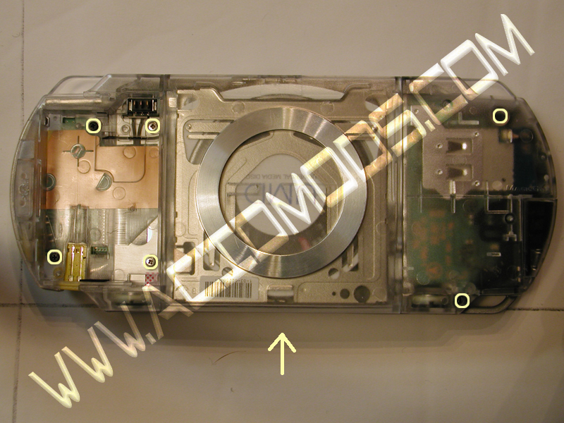

Now after your put in every screw test that the PSP turns on and
the leds too if they don't its a short.
Turn it over and screw in these screws-
This image is from Kenshinffx's Tut.
Now Turn On your PSP And enjoy your easy to do Sound Reactive Leds!
