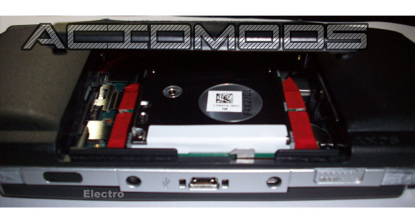

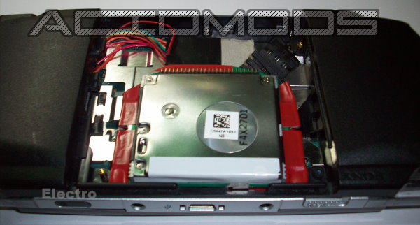

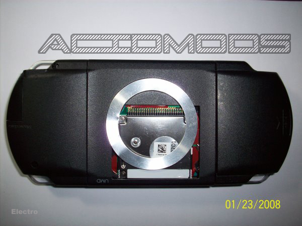

Here is how the Mod looks now.
I secured the HD so it will no longer move:

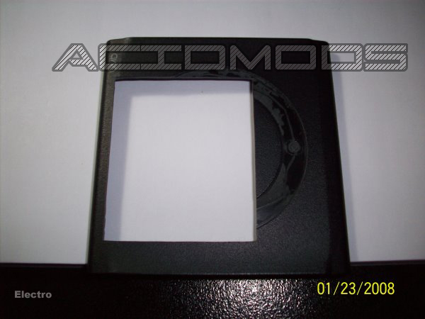

I made a hole for the HD to let the air get inside,  looks cool I think, and this will help it from overheating:
The Mod how it is now:

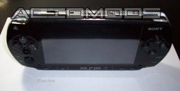

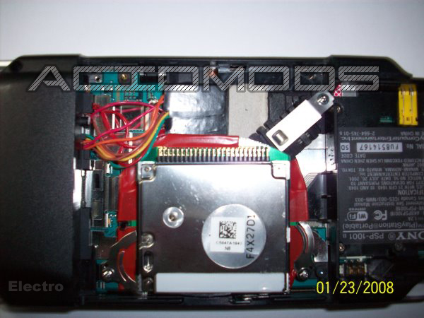

Here is the Finished MOD:
There is some room left over that can be used for some other smaller MOD.
Like the Internal Go Cam. :)
Compare this with the above:  :D

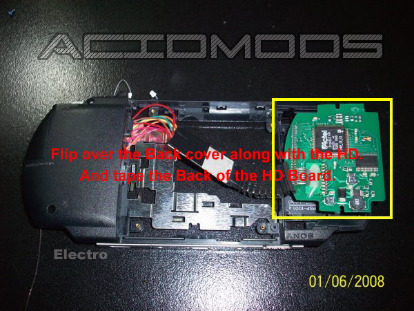

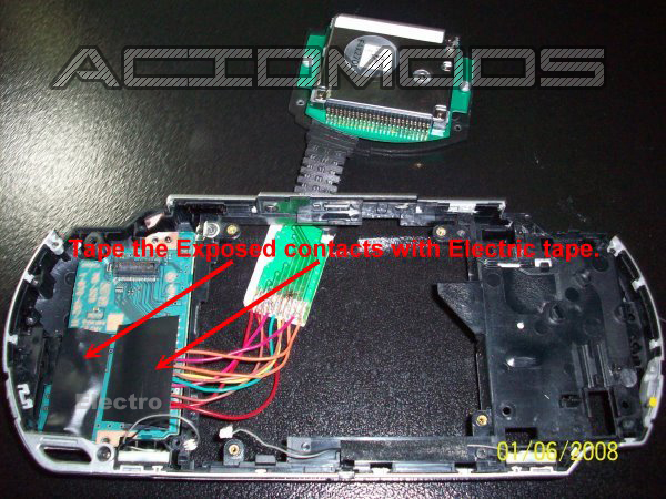

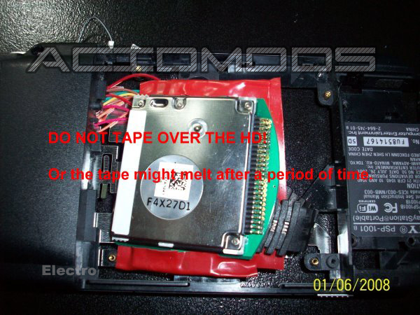

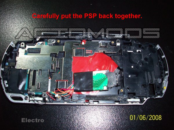

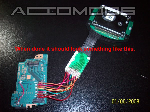

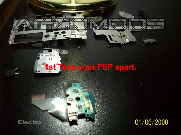

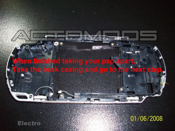

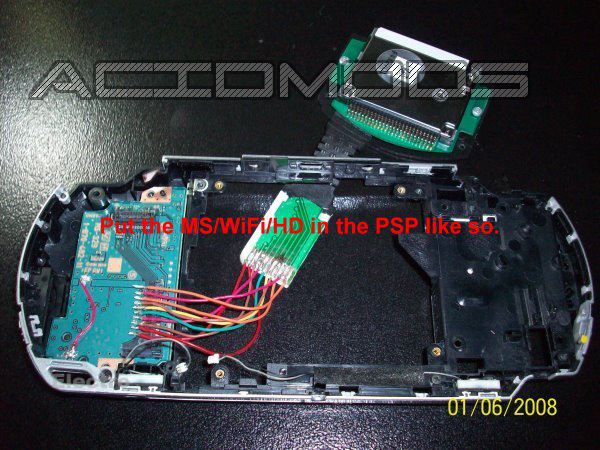

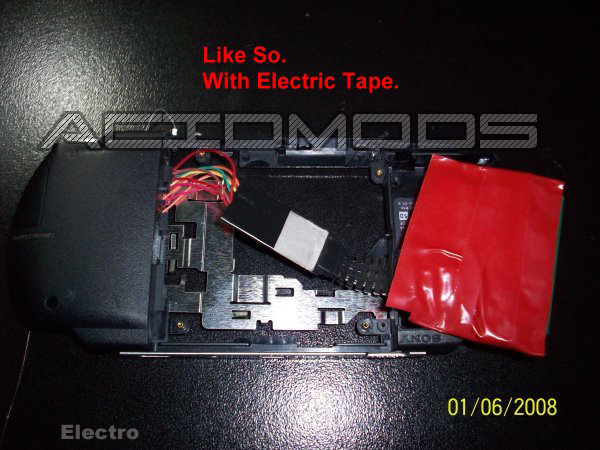

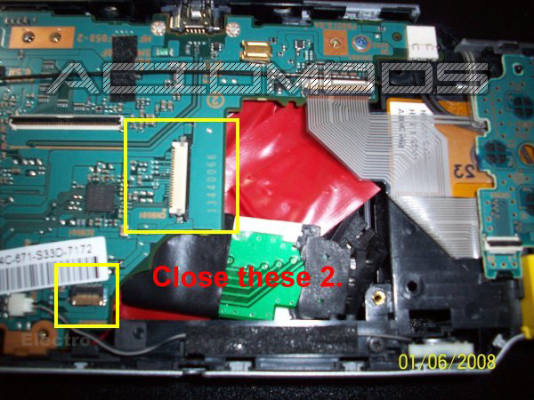

TUTORIAL:
U WILL NEED TO TAKE THE UMD DRIVE OUT!!!
And take the Datel HD apart:

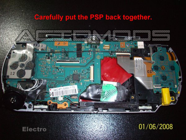

When U Put the PSP Together Turn it on and Enjoy.  :D

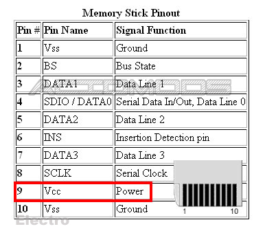

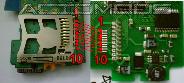

Here is the picture for the pinouts for the MS/WiFi board and the Datel board.
And U need to share the 2nd pin (9th pin by the MS Pinout diagram) between the MS and the Datel HD.
