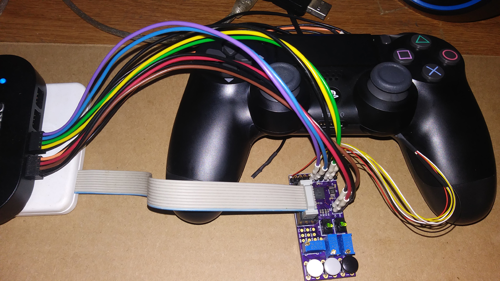

Here's probably one of the most complex ways of doing it. This project is just a protoype and has another intended purpose, but it can also match up the first new stick you toss in there to the controller, provided it's not all jacked up to begin with.
nice, but if its not an rom program unit, its just an overkill. actuall "stick drift" in 95% cases doesnt even need a solder iron.
