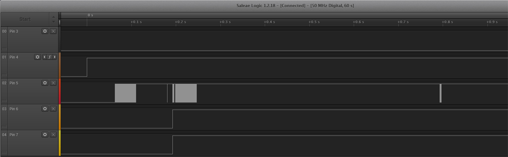

I haven't torn down the 1708 to trace where that J1 goes. It could be the JTAG header or just some debug port.
I tossed the Saleae Logic Analyzer on it and there's just a spit of what could be some data after power up and then nothing else. I see no CLK signal, so the JTAG header seems unlikely, but it could be the thing is setup to need some input on J1 or even some button combination to switch it on. You'd have to trace the entire thing out to see where each of those lines go to even start guessing there at what it's purpose might even be.
J1
1 - GND
2 - GND
3 - Low
4 - Hi
5 - Data?
6 - Hi
7 - Hi
8 - 3.3v
