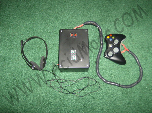

Creating Voice Recognition Controllers. Here is Part 1 of this video tutorial the SR07 board this is the brain of the kit and does require loads of soldering. This kit is super easy to put together. This controller board is what analizes spoken words and determins matches. I plan on adding this kit to a Xbox 360 controller for things like (Reload, Scope, Plasma...)  this kit can be found here http://www.imagesco.com/kits/speech-recognition-kit.html
Here is the 360 Voice recognition Controller I only used 3 commands in the video but I have 10 buttons connected to the device
Here it the assembly process.
Low Res Video 56k
High Res video (click on full screen to view up close)
Here is the final controller board.
Well your probably wondering how do I program it to my voice? Do I need a PC to program it? Well the answer is no all you need to do is assemble the included keypad and programming is as simple as pressing a few buttons. Assembling the included key pad is very strait forward and simple to solder. Here is a Video od the job.
Low Res Video 56k
Here is the Final KeyPad.
Well now that you have the keypad for entering commands your probably wondering how you will see what command number you are programming. With this kit it includes a digital display that displays the one of ten buttons you are able to control with voice commands. her is the assembly video of the Digital Dsplay.
Low res video 56k
Here is the final Digital Display.
To give you an idea how it work I created a small test video. As you can see you can program the device to any word and programming is very easy. You can program key words like "Reload" to free up button presses in the heat of battle.
Low res Video 56k
Here it is Assembled.
Onceyou program your desired words you can remove the keypad and display to slim down the componants.
Here is the relay board.
Here is the 360 controller attachment.
Update:
I spoke to the manufacturer of the chip and it turns out I have it set to long word recognition when im using short words so by changing it the system wont have to wait for the entire length. this should improve the responce time by half..

I'm currently awaiting my speech recognition kit (SR-06)
I'm a costume maker (http://marcwolf.org) who also has a keen interst in animatronics and special effects.  Something I have been wanting to do for a long time is to make my suit more realistic with wagging tail, moving ears, muzzle flaps and nose wrinkles.
I use the PicAXE chip range to control the servo's and to handle the sequencing.
My biggest difficulty has been with the input circuitry. I have experimented with hall effect switches in the gloves fingers and a magnet on the thumb but it is still too obvious that I am entering in commands of a kind.
Speech recognition looks to be the solutions.
With a series of whines, growl, howls and other sounds that would match my characters character I can use them to initiate the sequences.
Thanks so much for putting up the tutorials etc and for letting me know that what I am trying is workable

Got a POC Yet? Like seeing the 360 actually being controlled by voice? Another thing, i see you got a headset, would it be possible to 1, use the 360 Headset (Chat pad one) and 2, Have a switch so you could use the same headset to speak, or even a voice command to switch?
