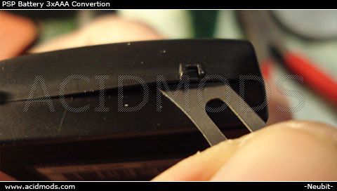

1-
First of all you will have to open up that PSP battery and take out all the guts. To do that you must jam something thin into the connection gap. I used a broken scalpel blade. Carefully slide the thin object along the connection and you should get the battery open without difficulty.

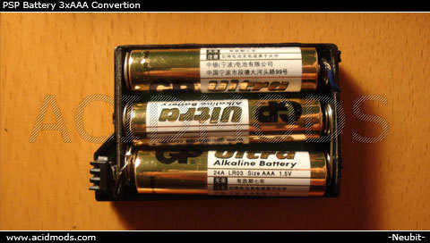

9- Remember the plastic you cut? now its time to glue on those springs onto it. Super glue works good. glue them as following.

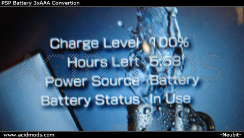

10- Now once that is done stick the plastic with the coils into the battery case and run the wires to it. Flat coil for the (+) and spring coil for the (-). Solder them in place as you see fit. This should make a connection that will give you a 4.5 V output from 3 1.5v batteries
11- Use more super glue to fix the plastic in place and viola! put batteries inside and pop the thing into your PSP. Will new batteries it should give you about an hour worth of electricity..
